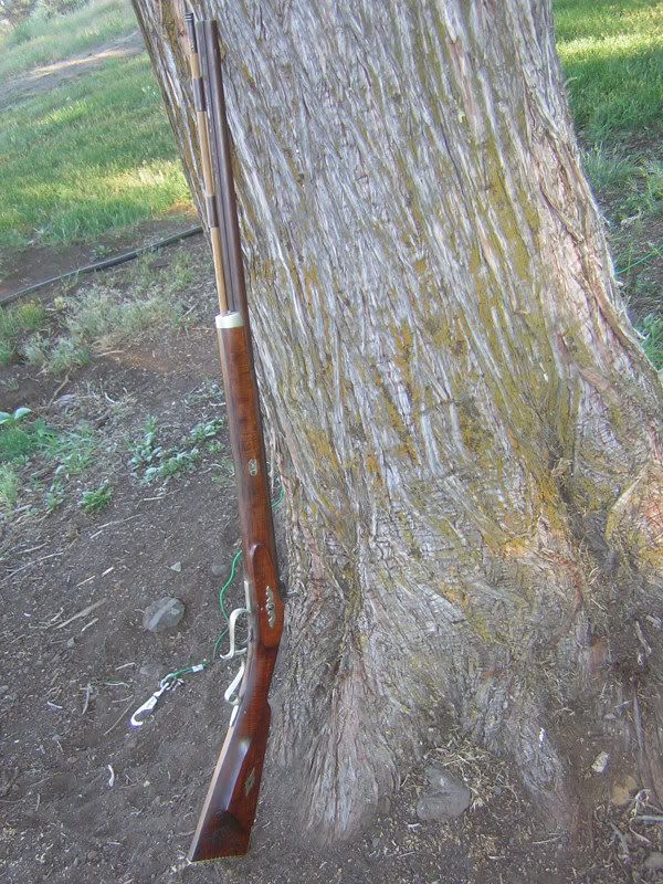

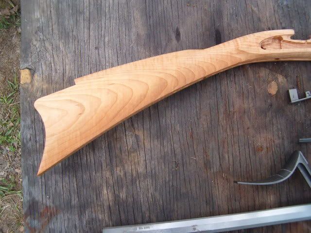

Heres a bad pic of my wifes 50 cal. its got a 12.5" lop and 15/16" x 30" barrel turned round for 20" .

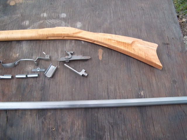

The trigger and tang were mistakenly not ordered but they are now
Got some work to get started on

I've built a number of rifles for kids and prefer to go with just a wee bit more barrel than they can easily heft, right off the bat. Why? For one, like any newbie to this sport, they lack the strength in the areas of the arm that make a steady hold possible -- but they'll build that strength in a hurry. In the meantime you can use a variety of rests, which ain't a bad idea anyway, since it makes it heaps more likely they'll score solid hits in the black, feel successful, and thus enjoy the whole shootin' match that much more. Another thing is, and this is important when you contemplate actually building a rifle or having one built -- if you build for the munchkin the child is now, in as little as a relatively few months and certainly in no more than a few years she will have outgrown your gift to her. Not such a bad thing -- it's never bad to have an excuse to build another gun -- but you can put off the inevitable and allow her to shoot her "very most favorite" rifle ('cause papaw built it just for her....) that much longer, if you allow for some growth on her part in the initial design.
Just my $.02, which is only as valuable as it is useful to you.

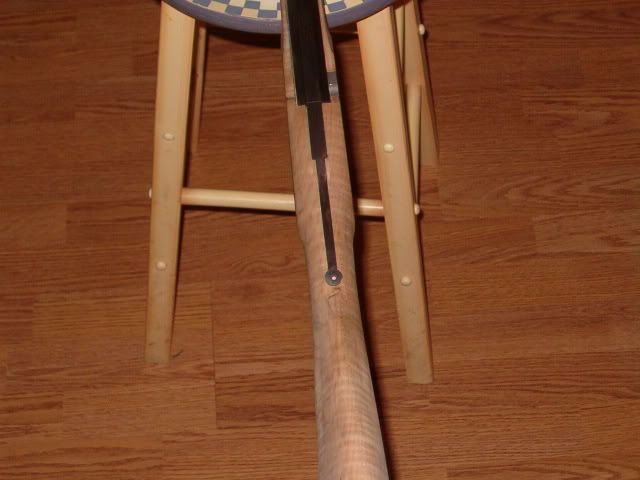

Got the barrel in the channel today Gonna be one LLOOONNNGGG Rifle

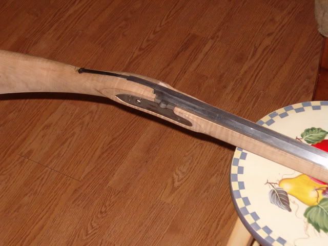

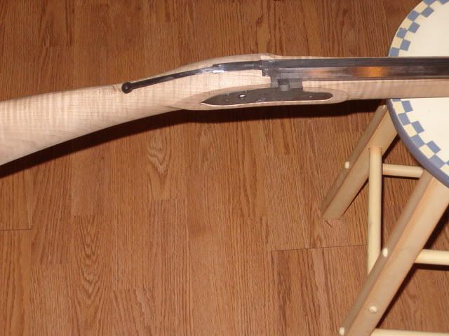

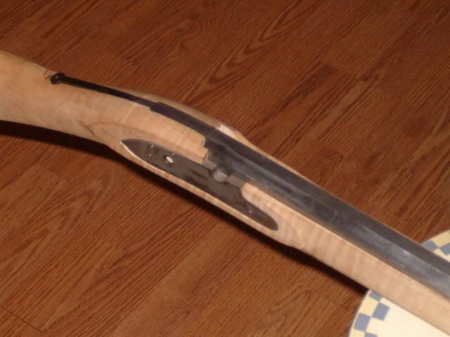

Made a little more progress today

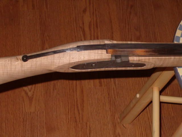

The tang barrel and lock plate are in
I'm gonna ask a question that will prove my ignorance of gunbuilding.
Where is the drum and nipple?  I'm guessing that you haven't installed them yet, but how is that accomplished accurately?
Top of lock plate is centered in the flat an 1/8" in front of plug. I use an old drum with threads cut off and the cleanout screw remove and a bit run through while held in cut out of plate to scribe a mark.

Thanks for the info Frank . Was wondering how I was gonna do it
Don't have and old drum but I'll buy an extra or two
Do I need to get the tool from TOTW to locate the nipple??
