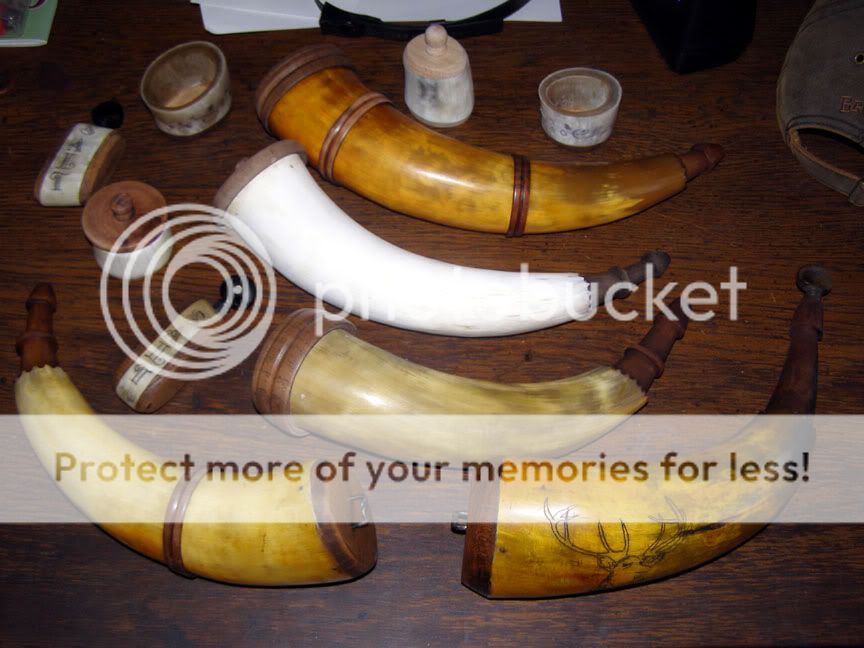

I use a palm sander starting with 80 grit, finish with 220. Much faster than by hand. If it is getting scrim I stop there til after the scrim is done, than seal it. You can use any number of sealants, paste wax is good & easy. Or, minwax stain & sealer. Use a dark stain to give it an aged appearance (most will wipe off, & it will show if you missed anything while sanding), then the paste wax. Beeswax will work & is PC, but hard work & time consuming. If I want a highly polished look I use Jeweler's rouge on the buffing wheel, or sometimes whatever is laying around. Experiment with different abrasives, you can always take it back to the 220 grit if you don't like the result. Do NOT use too much pressure, you can discolor the horn. I build lots of horns, most weeks at least a half dozen a week sometimes more. Using power tools really helps speed things up & puts less strain on your body.
An example of one weekends output...
dsrtfox1942
Really like that elk on the bottom horn.
power tools do make for a quicker ,easier job ,but be careful it also makes screwing up a lot easier ! I know ,I`ve done it !  pnic  ROFL
