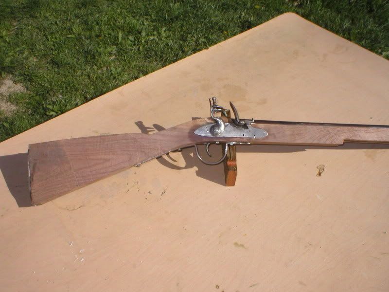

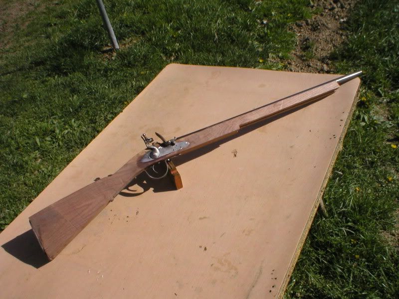

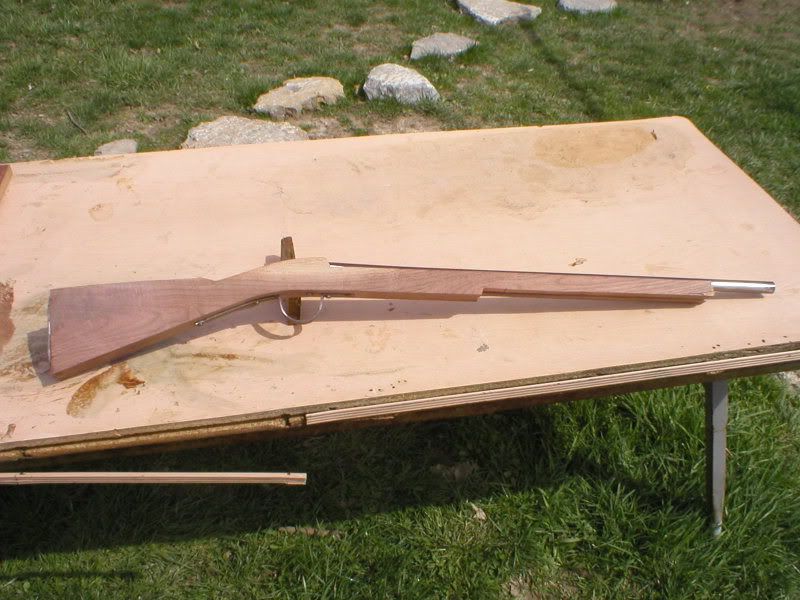

Quote from: mongrel board=ml thread=1883 post=20980 time=1271462964Haven't ever built one of these, but so far, other than inletting a round, tapered barrel, it's about as simple a build as you can get. They designed these things to be built fast and sold cheap, back in the day -- ironic, really, when today a good PC replica will set you back the largest chunk of $1000, if not more. Funny the huge sums people will pay to have correct appearance of a poor man....
Dennis (Dryball), the owner-to-be of this piece, ain't investing near that much. Other than the barrel not being octagon-to-round, though, and being shorter than on new originals, this is a pretty awful close replication of the guns traded to Indians for furs, way back, and incidentally favored by a lot of mountain men and others who appreciated a cheap smoothbore that could double as a game-getter and the muzzleloading equivalent of a riot gun.

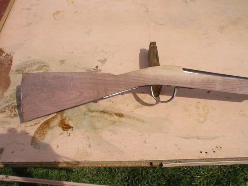

A big lock I've had laying around on the parts table will get inletted this weekend, at the same time I'm finishing Andy's Mountain rifle and making progress on other things. A handy and needed rain moved in tonight and there won't be much work done outside, for my customers in town. What a pity -- a weekend spent largely in the shop.
Unlike on the vast majority of other guns, the guards of these things weren't inletted, they were simply screwed down flush with the surface of the wood. Like I said, it's a simple gun to build. Absolutely nothing about them to consume unnecessary time....
The barrel is a 28" 20 gauge from Numrich, the stock walnut. The lock, not seen here, is an oversized flinter with Siler internals.

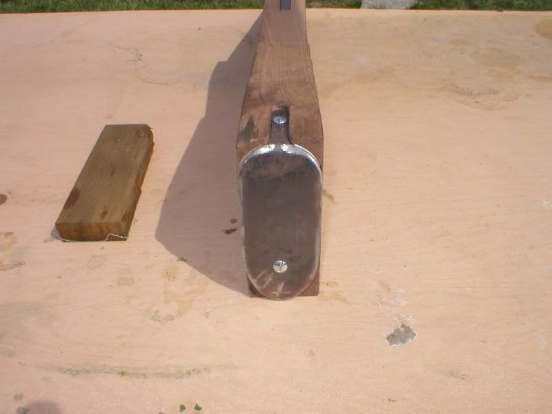

Buttplate -- 4 1/2" tall and a full 2" wide. There will be about zero felt recoil on this gun.
