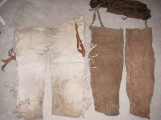

Well, folks there it is. The probably very incomplete but basic process. I hope never to do it again. it is hard work virtually every step of the way. The results almost make it worth it. I've sold hides for hundreds of dollars to some of the most famous knife makers and their wives, I've made leggins, dresses and shirts out of em and I can honestly say they just don't hardly ever wear out. the more ya wear em the better they get and if they start gettin funky take a pumice stone, scrape off the worst grease or stains, re-brain em, smoke em and bingo they're good ta go again. (ya probably don't have to rebrain em but I did).
