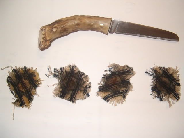

#8
This is the best I can do these are normal cut at the muzzle patches from my 54 shooting a 90 gr charge of ffg Goex
#9
Jerry I haven't cut any patches at the muzzle.  It's interesting to see what they look like.  That's one fine looking patch knife!
