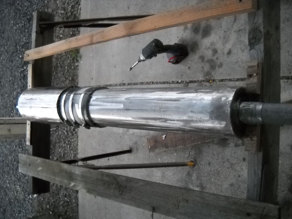

Got further along today. Yesterday before I welded the liner to the barrel on the muzzle end, I found that after cleaning up the metal on both pieces, there was a tiny bit of slop between the two parts. So I shimmed both ends (we are talking .015"), welded the muzzle end together and tack welded the breech end. Yeah I know, it doesn't really make a difference which end is which at this point, just let me live in my fantasy world. Then for about an hour and a half,using two propane torches and my gas welder, I melted and poured about two pounds of solder down between the tubes. I was a bit shocked at how much solder it took to fill that tiny, tiny space. But we don't want any air between them to allow the barrel to boom out to the side instead of out the front. Anyway, got that part done and capped off the back end then cut out the chamber reinforcing section. (Don't you like how I am making up these terms as I go along?) This part is seamless drawn stainless also, so I am now scrounging about for some steel pipe sections that will fit over the stainless and let me seal it away so it looks correct ( To keep RB off my case). So far my investment in materials is, let's see now, move the multiplier, add the columns, carry the 3, oh yeah, $0.00. Yep, nothing, zip, zilch, nada.I would like to continue that trend for the remainder of the build, if possible. Of course I don't count the consumables, but who does anyway, no one. So when it is ready to return fire to that vexatious Red Badger, he will know that he is being fired upon from the discount section.
Here it is waiting for some more solder.
Now I have to wait until Monday or Tuesday before I can make it to my scrounging sites and continue.

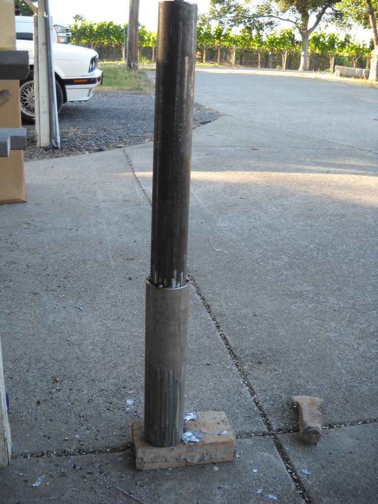

More work that can't really be seen. Drilled a tight hole down through the breech end and pounded in a pin I made from a broken screwdriver and welded the ends for that extra touch of security. I don't remember how to do the calculations and can't find any reference material alluding to the relative strength of the finished body, but I will estimate that it will be at least 5 times stronger than the original cast or cast and banded cannons of the time. I actually had to pay for a section of 4" pipe I picked up at a scrap yard. There goes my budget, $17 out the window. Oh well, I guess nothing is ever free.

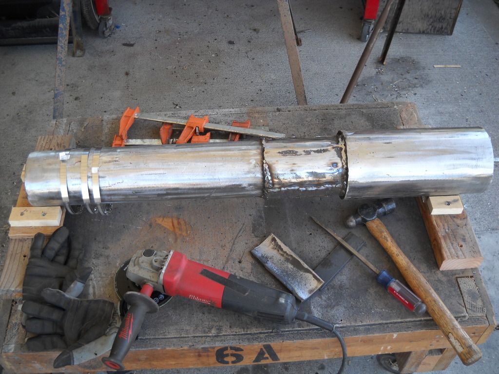

It's coming along, slower than I would like but hey, that darned job keeps taking up my time. Anyway, here are some pictures of the progress so far.
Muzzle end before the reinforcing tube and welded cap.
The first try at the second reinforcing tube. 5" iron pipe cut into quarters. It refused to cooperate so it was scrapped and then i tried this:
Several 6" lengths of 1/8" mild steel, welded on one side then pounded down and welded on the other side.
My math was correct and they all fit.
Now to touch up the welds a bit, then attack with the old angle grinder, bands at the muzzle end, breech end and at the front of both reinforcement tubes. Of course then I have to figure out a way to get this to rotate so I can smooth and shape it a bit. It already weighs over 125 lbs and is not exactly easy to manoeuvre around. Once I have it smoothed I will attach the trunnions and sand blast this baby. Stay tuned for more updates as they happen!
