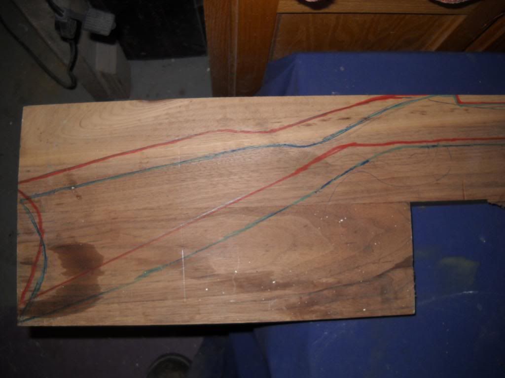

I have been toying around with the idea of building a rifle from scratch but didn't really think I could pull it off. Then I got a couple of back locks from mongrel and was thinking of making a new stock for a Sears Kentucky rifle kit that I bought without a lock. Now I have all the parts so its time to give it a try. Found a ripping of 8/4 walnut in my scrap wood bin, cut off a length and glued it together (don't tell mongrel) to accomodate the butt end. Then I traced out the profile of both the Lyman GPH and the Kentuckian.

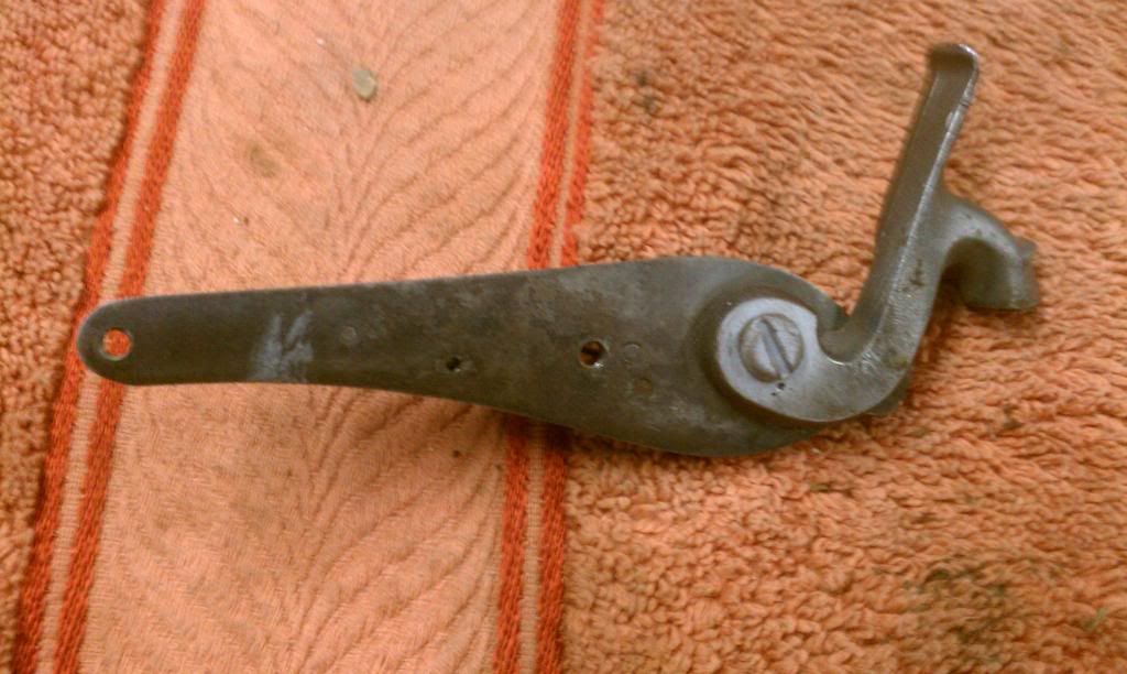

The red is the Kentucky and the blue is the Lyman. I did not realize the drastic diffferences between the two. I like them both but after seeing them on wood, I am not too thrilled with the belly on the Lyman. A small thing I know, but then again it is the little things in life that makes us happy. Here is a picture of the lock:

I like the belly myself, but you can use the same outline and use a straight edge to eliminate it. You aren't locked into it and it's an easy fix. Won't affect the structure of it at all.

If you have both actual stocks in your possession, go with the pattern that more-or-less feels best to you, and make note of the details about that pattern (say a too-bulky cheekpiece or a too-square forend -- or a belly to the lower profile of the butt) that you don't care for. Take what you like from either or both, modify or eliminate what you don't like, and do whatever else seems right and proper to your hand and eye as you shape your stock. Then take the finished rifle out and shoot the snot out of it, and discover what maybe needs further tweaking or doing differently, and this will be your incentive to build your NEXT rifle.

Which style stock do you feel more comfortable shooting? It ain't gonna be traditional so make it comfortable and add the features you like best. Heck you can even experiment a little!

I love those scales. It's always amazed me how you can get some fantastic looking parts out of wood that is destined for the burn pile. I think I am going with the long rifle style with a little more angle and depth on the wrist and bit lower comb without a cheek piece. when all the parts are organized I will start posting pictures.

do not discount a cheekpiece with a 2" plank. It can be done, my current project started with a nice plank 1 15/16" wide.
The widest spot on the cheek piece is 1 7/8 &) but with judicious measuring and careful shaping it can be done. Besides a cheek piece doesn't need to be prominent just well formed.
#13
I agree with Bruce 100%, and if the buttplate you select is no more than 1 3/4" wide you don't even have to hold your tongue and squint just so as you're laying it out, to have ample room for a cheekpiece in a 2" thick plank. If you start looking at the wide variety of buttplates available from the various suppliers, you find that there are many plates with many different degrees of curve to them in the range of 1 3/8" to 1 5/8" width.
Of course it's easy for those of us who've built a number of rifles to sort of have it slip our minds, that the shaping of a cheekpiece in addition to the basic shaping of a buttstock can be a really nerve-wracking chore. If it weren't that they all use a combination of octagon-to-round, or round, tapered and often swamped barrels, which I charge extra to inlet, my labor rate for doing a fowler, fusil, or musket would be at least $25-$50 less than what I charge for the work on a traditional longrifle, for the simple reason the tapering flow of the main portion of the butt into the comb and wrist isn't disrupted by a sculpted chunk of wood raised some 1/4" to 1/2" more from the surface of the butt. Just visualize the lines and curves changing direction and shape, and the grain of the wood refusing to cooperate (which can happen even when the stock blank was chosen with grain flow and ease of shaping in mind), and leaving the cheekpiece off can start seeming like just the logical thing to do.
I didn't mention it earlier -- but, were it me having glued the lower portion of the butt to the main stock, I'd run a glue-coated dowel right up through the bottom of the butt and into the main body of the wood, after rough-shaping is done and you know for certain where you can drill without the results being seen, if you install a toeplate. I seriously doubt there will ever be any trouble with your glued seam separating, but even after it's been cut from the fallen tree, dried, milled to a smooth plank, and shaped -- wood is a living thing and can be contrary about us taking anything for granted.
