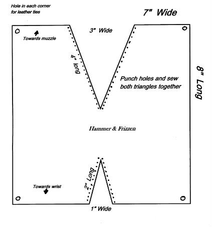

OK. I need a cows knee and it doesn't look like too hard a project, any suggetions, drawings, pointers, help!
I believe it should be made of leather right?

Here ya go... ;D  Get ya some "soft" leather, artificial sinew(or equivlent) and yer favorite water proof'in stuff. ;D
