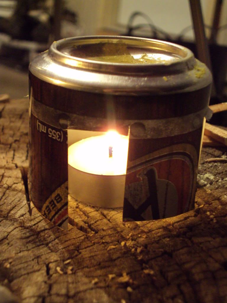

I made a simple sulfur melting set up, using an old pop can and a tea candle

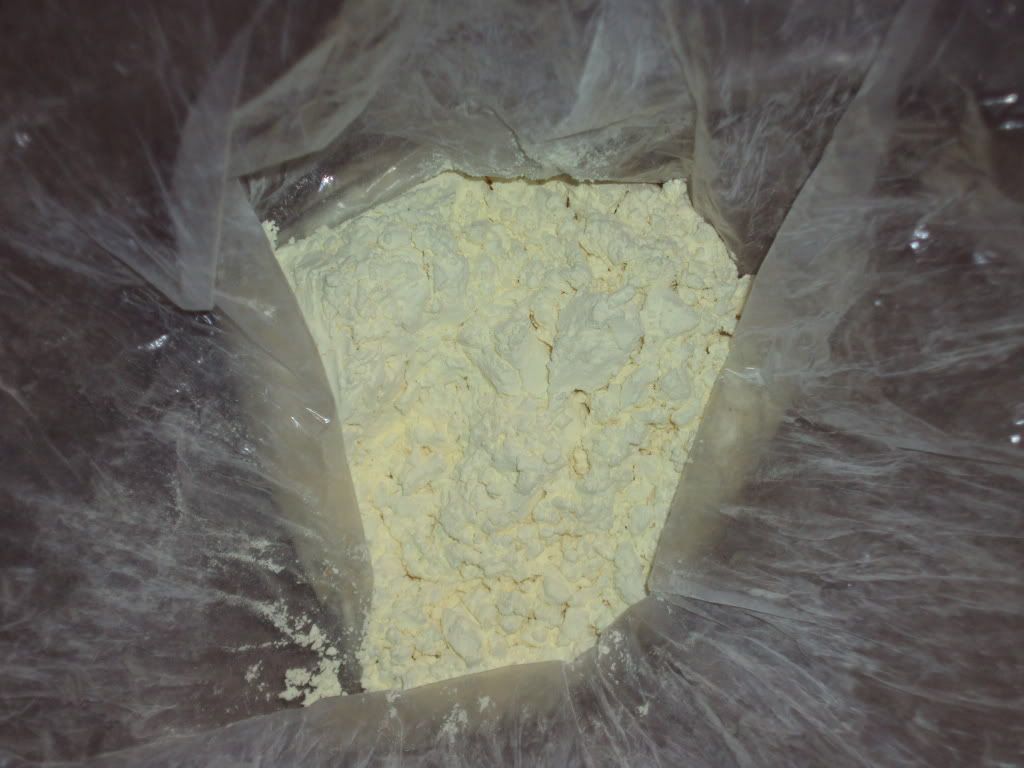

Powdered sulfur, this was from a friend, but i am told it is also sold for fungicide for plants and trees at the hardware store.
I simply let the sulfur melt, which really doesnt take too long. And also made sure to have a breeze so the air was moving and I didnt have to breathe that nasty sulfur in! And then dipped mine splints into it.

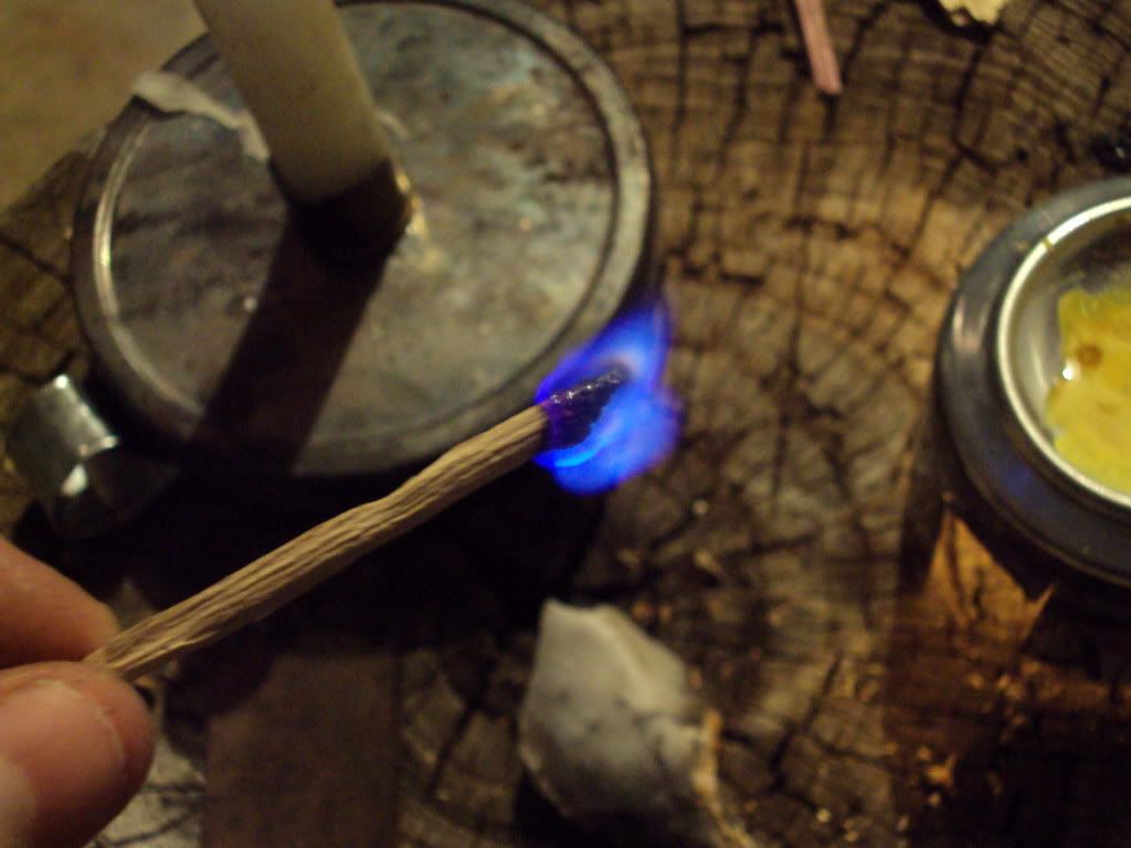

they light quite easily
i made several different types, some more modern match size and others alittle bigger (as was said to have been used in europe)
I had also come across mention of them being dipped in wax then coated with sulfur. I tried this as well and it really works well, burns much hotter and with a bigger flame.
