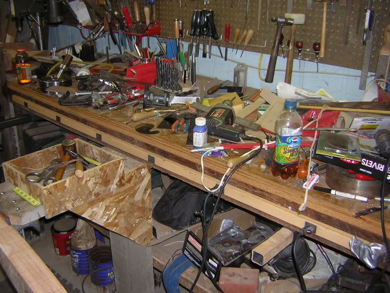

Heres the mess I have to contend with before I start makin a new one. Have to get the tools put back so I can find them :)

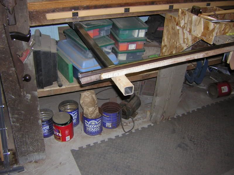

I just finished swapping out my machinest vise for the 10" woodworking vise and added a couple supports on the left and right sides of it 24" from it for supporting the stock. I stole the idea from Roy  ;D

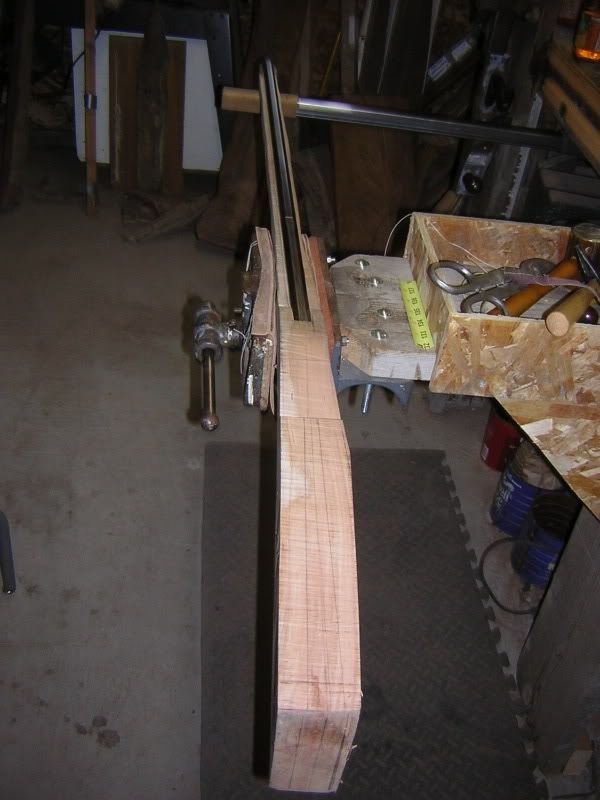

Heres the salvaged blank from the mess up with the roto carve duplicator I mentioned above. It took some plannin and whittlin but I think i made it with this skinny little barrel inlet into it .
Heres the shot of the forestock after bandsawing the oops away.

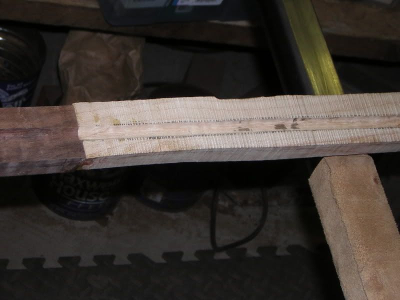

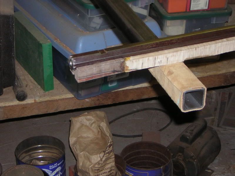

The forestock petered out and was too thin because of the 'wow' the duplicator made and I had to cut the stock back and add a hunk so I used a hunk of walnut for grins. When I pull the barrel out I'm going to cut some grooves inside the channel on the 45deg flats that overlap the walnut and maple to epoxy in some threaded screw stock for strength on the tip.
Here is a shot of the ramrod groove after its hogged out with chisels and scrapers. It still needs a bit of sanding with dowel wrapped in sandpaper.
