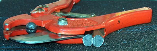

SPUR UP ! And here's why. If you cut some of your own or bought cast balls in half, I'll venture to say you'll find holes(voids or vacuum spaces) in most of them. The voids are always perpendicular to the earth and located somewhere between the center and the upper part of the ball. The balls pictured below are from a bottom cast furnace. You can tell because of the position of the void. On a ladle cast ball you'll have the mold canted to facilitate runoff of the molten lead, hence the the void(if any) will be at an angle. By loading spur up you'll have a more constant ball rotation, as the gyroscopic center will be more constant from one ball to the other. This is nitpicking, but can and will make a slight difference..
At a later date I'll how post to cast 95-99% void free balls.

Of course that ain't true. But he knew something was askew and that was a his rational assumption. When you tumble the spurs off, the bigger voids will show thru as a dimple. The ones you see here probably won't show. You can see that if you align the voids at different positions the gyroscopic centers will be quite different...
