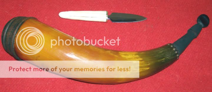

Rit golden yellow dye for the body, Fiebing mahogany leather dye for the tip, followed by a wash of Minwax dark walnut stain overall will get you this...
Vary what you use & get any number of different finishes...
