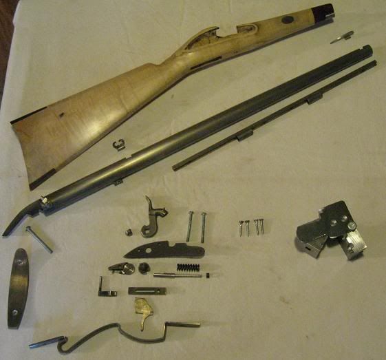

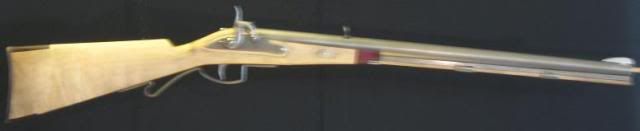

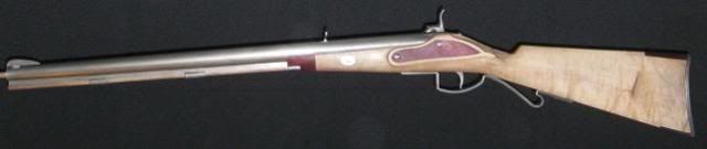

I should have been shooting pics and documenting the build all along, but it's to late now, so I will just show you what I have.
I built this one as a speculation gun, it will be in the for sale section as soon as I work up a load and sight it in. I'm hoping to raise a little extra x-mas money with it.

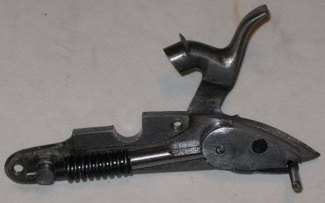

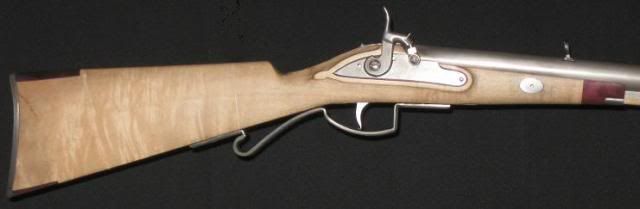

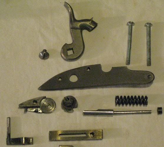

It is a .32 Caliber, I built every part on it from scratch, except the barrel liner and the nipple. All the other parts including the lock were built from rough stock. It weighs 4 pounds 5 ounces, is 33 1/2" long OAL. The length of pull is 11 1/2". The inlays and the forearm tip are purple-heart, and the stock is sugar maple, it has a nice bit of figure in the butt. The pearly gray finish on the metal is an acid etched. finish
I'm planning to offer some letter engraving to whoever buys it. I'll engrave a set of initials in the lockplate and the trigger guard for free. And it will come with the bullet mould and whatever bullets I have left from sighting it in.
Colin
Sure is a nice looking little shooter.......might have to look into that one.
Looks like a miniature Rigby rifle !
CowboyCS
Quote from: FrankG on November 04, 2008
Purdey actually, Purdey's have the trigger guard grip and straight stock, while Rigby's have the pistol grip stock.
C

CowboyCS
It was cold but calm this morning, so I finally got a chance to work up a load and sight it in. This is ten shots at 25 yards, patched conical over a 22LR case full of FFFg.
A Half dollar will cover the group.
I'm not gonna show you the sight in paper, it looks like I hit it with buck shot from a 12 gauge.
C
