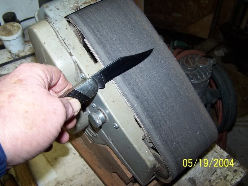

A belt sander and a cotton buffing wheel..
A belt sander upside down in a homemade stand..
My belt rotation is down and towards me...up and away ought to work just fine too...
I ALWAYS grind/sand from the spine to the edge...
A well worn belt works best for touching up an edge..aluminum oxide, zirconia, no matter..
A light touch is good.. no need to bear down hard...
A can of water for a cooling dip after every pass..
22 & 1/2 degree angle (thereabouts)
One swipe per side..from handle to tip...then go to the other side....
Don't hold the knife stationary and 'rock' the edge.. MOVE the knife across the belt
You are looking for a 'wire' edge..You will see the light reflecting off it as it develops..
Once it's nice and even on both sides, no gaps or missing spots...you're ready for the buffer..

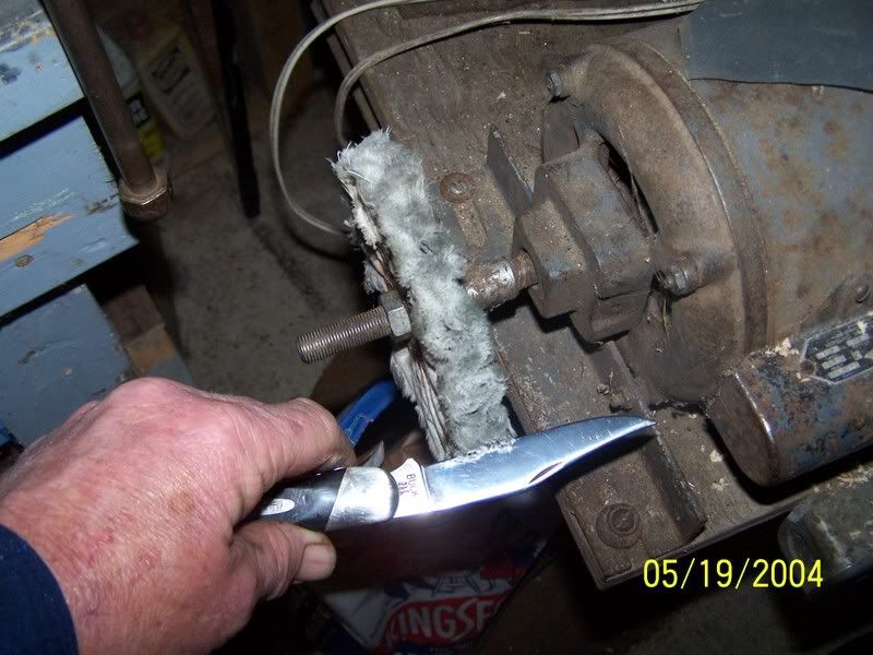

On the Buffer....
I hold the edge perpendicular to the middle of the wheel..
Just barely let the wheel kinda brush the wire edge...No more than 1/8th inch.
You don't need to feel any pressure from the wheel on the edge..
You looking for the wire edge to 'disappear'..(it's going to the other side)
One pass on each side...alternately...
Might take 8 or 10 passes on Gooood steel.. some stainless mebbe 2 or 3....
You're done when you get a clean pass on either side..no wire edge reflection...
Now you can SHAVE with it...

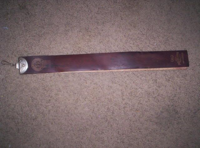

SG is this what you are looking for?
Mike
