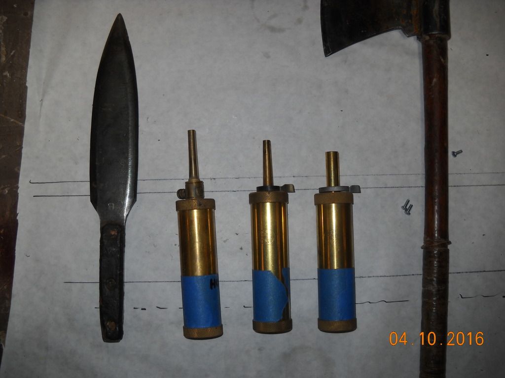

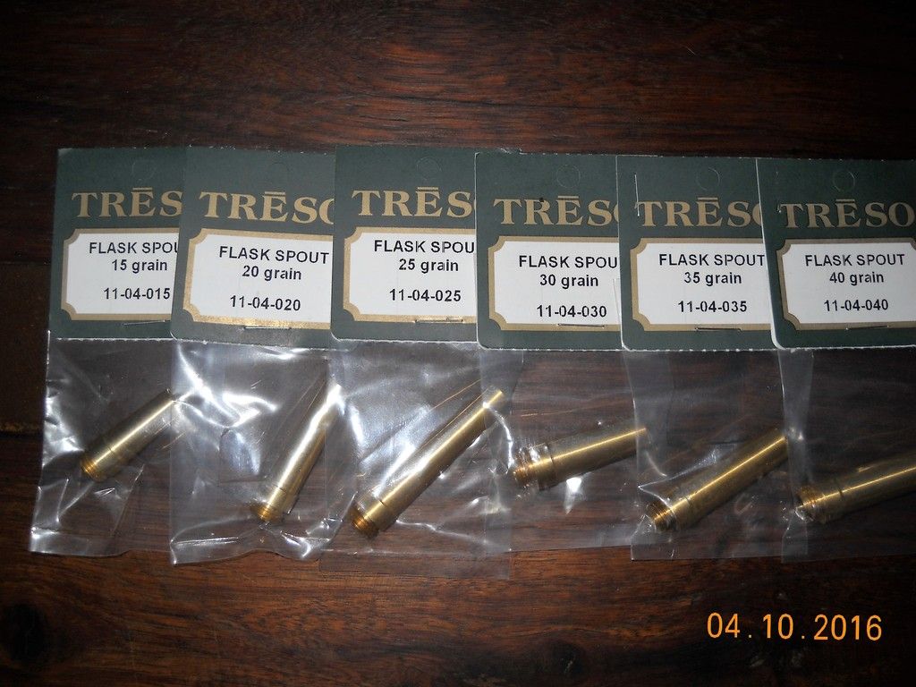

For some reason every time I join in with a group that is shooting, it becomes a contest. The trend lately is less powder horns and separate measures and more brass canisters with sized tips. Makes sense to have a safe way to eliminate a loading step, and I happen to have acquired a few of the canisters. And now that I have pretty much figured out the optimal powder load for most of the smokepoles that I shoot it only makes sense to have dedicated powder devices. After spending way too much time perusing different sites I scored these tips on EBay. $30 for all six is not a spectacular deal, but it was reasonable.
Already having several tips from 40 to 90 grains, this covers most every combo that I should come across, and given my shaking hands should give me the consistency I need while loading.
Given my tendency and propensity to make things explode (on purpose and for fun) we have tested each of the powder canisters for safety by (at least twice per canister) burning the tip load (by fuse from a distance) on a full canister without any of them blowing up. For scientific purposes only of course.

Did you measure the tips for accuracy?
I found that none of the tips actually held the weight of black powder that the volume measures stated. The 70 grain one held 68.4 grs. of 3F BP., The 30 grain one held 28 grs.
All I tested came up short by 1.5-4 grs.
According to Sam Fadala, Black Powder is an "Inefficient" propellant. His finding were that +/_ 3-4 grains make no difference in most rifles and pistols. To have a 70 gr spout that throws 67-68 grains should have no effect on either accuracy or velocity.
I do tend to tune up most of the measuring devices I wind up with, but obviously only if they are measuring too strong. I don't think that anything I have ever had was off enough to make a real difference. At least not with my meager shooting abilities.
I personally will not use such a device... "Makes sense to have a safe way to eliminate a loading step"  is an inconsistency... I have seen people hit the button on these things and then when the powder is in the tube pour it into a rifle barrel and when they pull the device away powder pours all over the area because the shut off device fails, or worse the finish the load and pull the trigger to find out they put a double or triple load of powder through the gun...
I will always use a separate powder measure.  Just my 2 cents worth...

Using a separate powder measure is required at all matches that I am involved with for safety reasons.
Your safety test worked that time, but what happens when there is some wear on the valve or a little dirt and grit gets into the valve and it doesn't seal completely?
I use flasks with a pour spout rather than horns, but I use a separate measure even when shooting on my own.
I have only known two guys who have experienced a flask or horn going off, but that is 2 too many. Don't let it happen to you!
