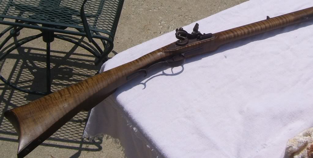

#57
This rifle is done with vinegar/steel "salad dressing" stain. Not the color I had hoped for but what the heck.  Nope no neutralizing was necessary. Just dried it with a heat gun. polished the whiskers off and used tung oil for finish.
Maybe not the color you had hoped for, but very nice all the same.
Tim Ault
Quote from: BruceB on March 31, 2013
Did you apply it atfull strength or dilute it some more ?my diluted mix is a light red color in the jar.
