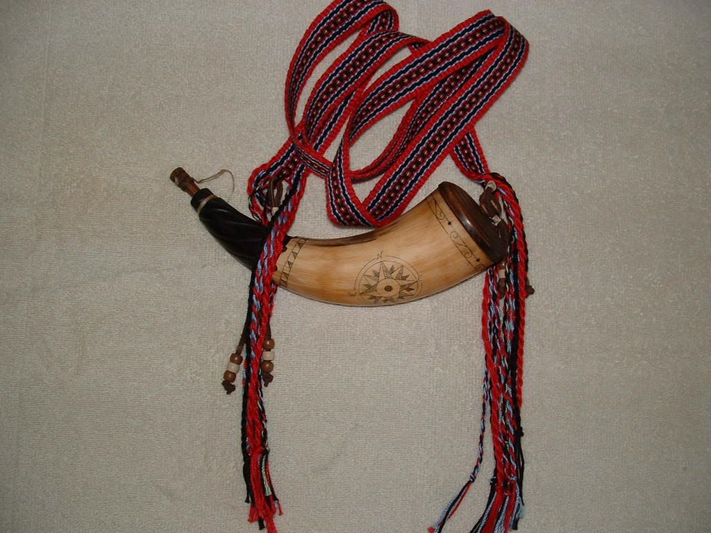

Here are a coupla pics of the current state of the horn.
Linc

My first horn is basically done. I have posted this in the Powder Horn forum.
