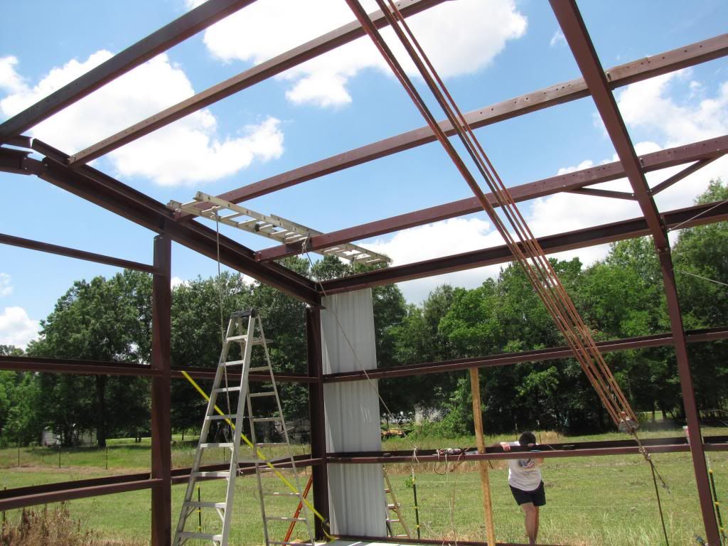

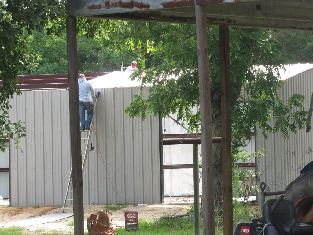

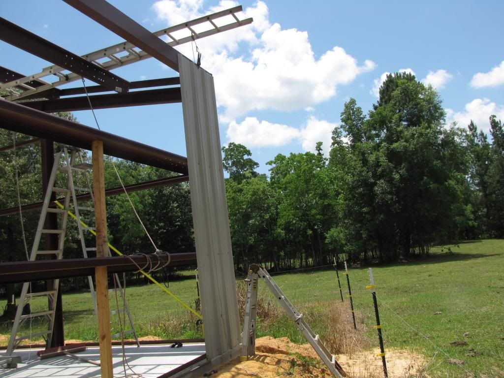

Crane and Operator! First sheet up! We set the starter sheet and quit for the day. I'm back on my own now, she works durin the week, and I cant work by the weekend!  srndr
Another view of the crane. I Rigged it so I could move it for the next sheed with ropes from the ground. Ladders really hurt my feet.

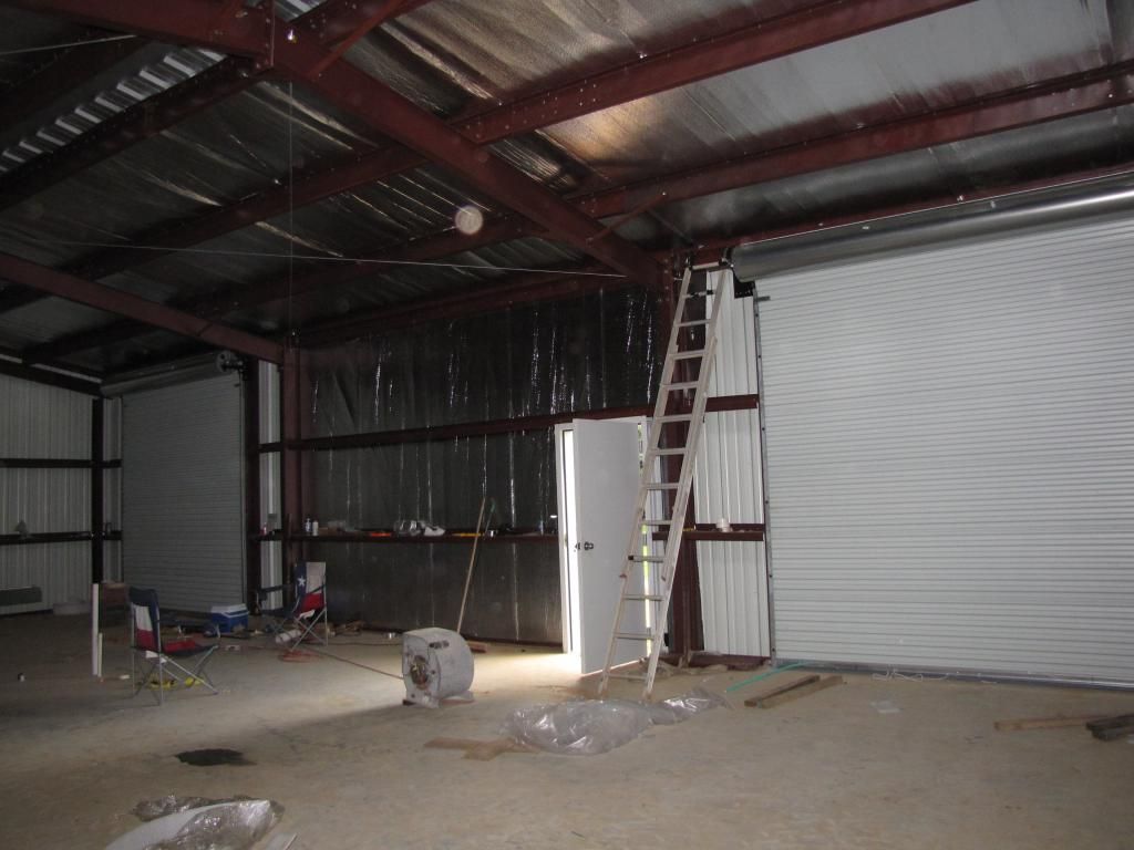

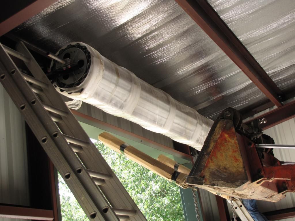

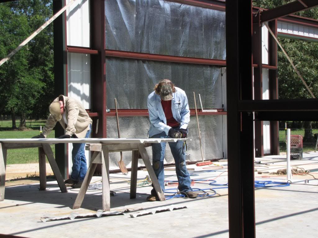

Starting the center bay insulation. Yea!!! Insulation and wind and no help!  pnic
One down, Three to go!
Turnin the corner on #3!

Just wonderin bout your project,  lookin good.  What's that silver stuff, a vopor barrior/insulation ?   Looks good....Tom
     That silver stuff looks like the insulation we use on heating and cooling ducts.  Silver on both sides that sandwich bubble wrap.
sweed
Pilgrims got it right. All the above.  I didnt want any of that plastic coated stuff for the bugs to live in. Its just in the center bay. Its allso a Radiant barrier. Supposed to reflect the radiant heat back. There will be 3 1/2" glass ins. inside those walls also. Center bay will be air conditioned.

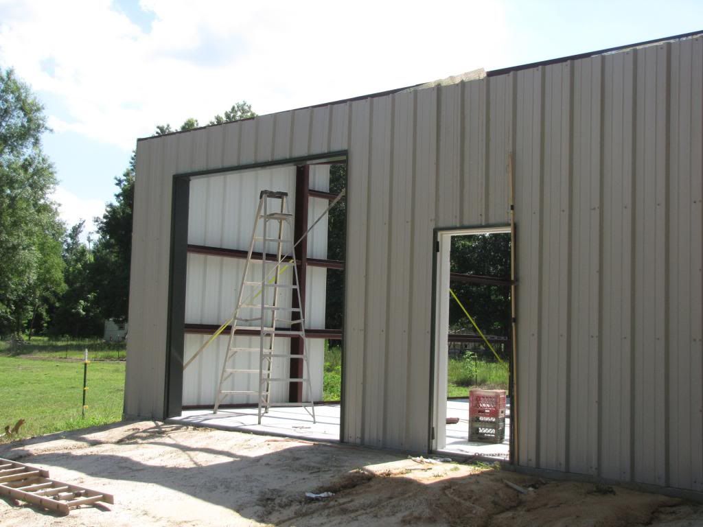

Locked up the shop 10jul14. Yippie!!!!!!! Here is some finals.
Now I have to install 14 windows, and start on the interior framing. See yall latter!!!
