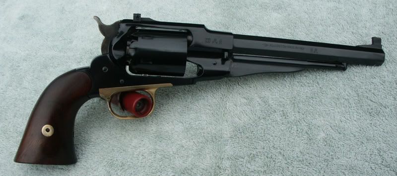

When you get her in, some photos would be nice.
madcratebuilder
Fed ex came today with the Pietta.  Very nice fit and finish, cyl feels tight with very little endplay, the trigger has a lot of creep, but that an easy fix.  The hammer spring feels very weak, hardly any tension the last 1/4 inch of travel.  That shouldn't be hard to fix.  Very pleased for the price I paid.

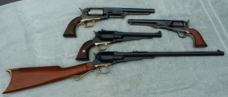

I hadn't planned on another so soon, but I ran across this carbine so cheap I could not let it get away.  NIB, Uberti 58 carbine for $300.
MCB, that carbine is something wildbull and I have both really wanted for a while!
Very nice collection there.   I'd put that pic in my sig line of I were you!
Yes That carbine is a blast...literally! I have had a couple over the years and I should warn you...they spit! Make sure you wear shooting glasses if you care for your eyes...and earplugs as that short barrel is pretty loud. But, the ones I had were accurate and reliable plus a whole lot of fun! Oh, and keep your off hand behind the cylinder or you could lose a finger or two in the event of a multiple discharge. Be safe and you'll love it.
Mike 56
Nice collection 60 Colt, 58 Remington, Walker, and a carbine. You have it about covered.
Mike

madcratebuilder
Update on the 58 Pietta.  The mainspring screw was about two turns out, so hammer is fine now.  The sear notch on the hammer was about 3/32 deep.  A half hour of stoning and testing I have it down to just a touch of creep.  I'll shoot it some more and see if it changes.  Both the 58's shoot great, I shot a hundred rounds yesterday and I'm impressed with the carbine, if I spend some time working up a load I think it is capable of two moa.
