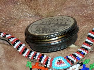

I've recently come into a couple cans of Mink Oil from Track that I might as well use...and had a couple of questions:
1) Are there any particular benefits to using Mink Oil over other lubes? (ie: very cold weather?)
2) How do you apply it...ie:
A) Melt some into a stack of patches?
B) Wipe each patch across a can of it at the time of using it?
C) Use your fingers to rub it into each patch separately to pre-lube them?
Same questions for a 3rd can which is a 50%-50% mix of Beeswax & EVO.

it's all i use in cold weather,good stuff. i just wipe each patch on one side,stack'em till i have enough to fill my patch tin then nuke'em in the microwave.not in the patch tin of course,well once but thats another story. :o
 thmbsup Ive used it,liked it straight outa the can.Just rubbed my pillow tickin across it.

From a couple different sets of replies, it looks like cold weather is the main attraction...obviously don't need it here in NC.
Its too inexpensive to bother trying to resell it, and the 'tins' that it came in look like they would be worth keeping for something anyway.
Since my NL1000 is a proven lube for my hunting, "that ain't broke I ain't gonna fix it".
So I'll just microwave the mink oil into a few bags of dry patches and use it up plinking at the range.
