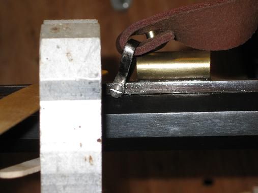

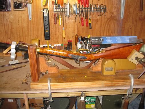

I used Beowulf's idea and I think it will work fine.
I used the TOW casting on the front and a button through the toe plate hole on the rear. It's setting up overnight because I reinforced the rib by using Loctite in the screw holes and between the rib and barrel.
