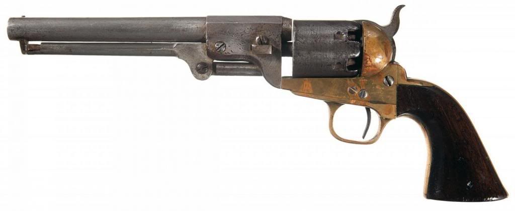

I picked up a Brass framed Hawes 44 Cal, according to the marks it was made in 76. Nice an tight an functions well but was really dirty an for some strange reason the barrell was painted black, I stripped the paint off an think I'll just steel wool what blue there is off an have that worn look, I did some searching on line it it looks to be a copy of a Griswold or a Ridgedon, Don't have any pics yet but here are some I got off the web that look like it. This is an original an the only difference I can see is my cylinder is not the smooth but the typical navy type with rolled engraving.
Again, this pic is not mine (I wish) but an photo of an original Griswold,
Above the wedge it is stamped ARMY an along the barrell it says Cal 44 Navy.

Not sure if the Hawes was a Spanish or Italian repro, but if I had to make a guess it'd be Spanish. I leave it to someone who enjoys internet searches more than I do, to verify one or the other or something else entirely.
Is the barrel octagon-to-round (as on the pictured Griswold) or full octagon, as on a true '51 Colt Navy?
The one detail about your gun that for practical use is completely irrelevant, but is still inaccurate in terms of strict historical correctness, is that so far as any surviving or documented examples go, there was never a .44 caliber version of either the actual '51 Colt or the various Confederate copies of the '51. There were a few .44 caliber Confederate revolvers made to roughly the same pattern, but they were larger guns in sheer bulk as well as caliber and are rightly considered copies of the Colt Dragoon revolvers, not the medium-framed Navies.
For most modern uses this point is -- well, pointless. And if a cap-and-ball revolver might just happen to be pressed into duty as what we politely refer to as a "defensive" weapon, the .36 is adequate but the .44 is a whole lot better, and a .44 built on a Navy-sized medium frame is a wickedly fast-handling piece of artillery. The Colt grip, specifically the Navy Colt grip (which is about identical to the grip on the Colt Single Action Army), is about the perfect design for fast point-shooting in average hands. At close range you don't have to aim -- you let the barrel of the gun take the place of your index finger in simply pointing at what you want to hit, use the index finger for pulling the trigger, and if the gun's steady in your hand you will hit not necessary dead-center but close enough to put a stop to most "situations". And as the gun recoils that curved grip rolls through your hand, bringing the thumb right up to where it needs to be to ear the hammer back for another shot, and with a bit of practice the process of cocking the hammer flips the gun back down to level. Point, shoot, repeat. There is a very good, practical reason that someone, somewhere, at some point said, "God made men. Colt made them equal."

Thanks Mongrel, it looks just like the one pictured, has a dragoon style barrell on it, it seems to be quite larger than a 51 navy as it fits my big hands quite well. Also its Italian made.
