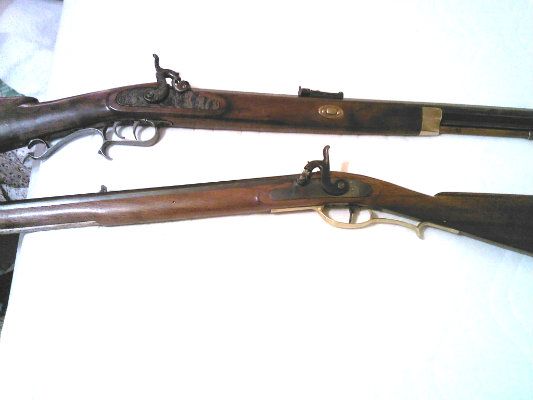

Can This be done? If a fella (me) takes a 32" bbl down to 20"(I did) in order to have himself a trekking gun,can you shoot shot from a rifle? Can you expect to achieve any accuracy out to 20-30 yards? With the patched ball I have no doubts,just curious as to buckshot.
  As usual any and all comments positive  or negative are welcomed. You folks know a hell-of-alot more than I. wtch
