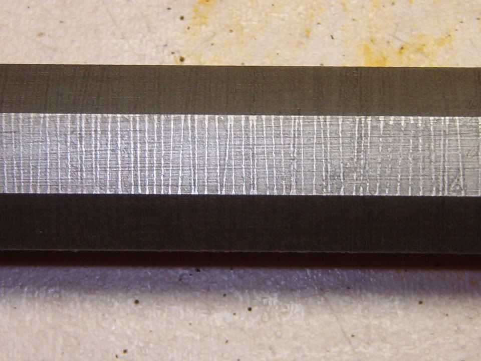

or you can use vinegar, less caustic and works as well will look something like this grey here
dont mind the lines, thats a faux damascus I'm working on
Jim, looks like English Fine Twist !!

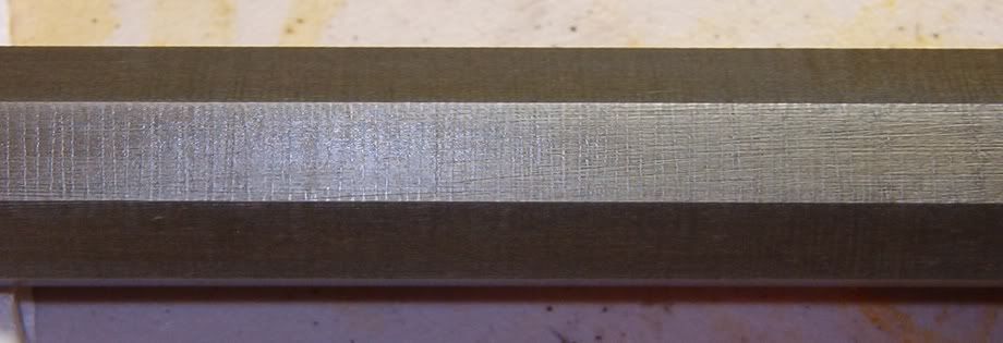

Thanks Frank, the trick is to not have the same width on the wrapping between the strings, not bad for the first time, going to try another, also, you really need a fine all cotton crochet thread or smaller, too fat a thread just doesnt look correct!

i don't have the weapon any more, but used  cotton kite string put the barrel on a spindle, and as it turned, ran the string from end to end, and in random distances,till it was covered, used a cold blue, it looked different.
