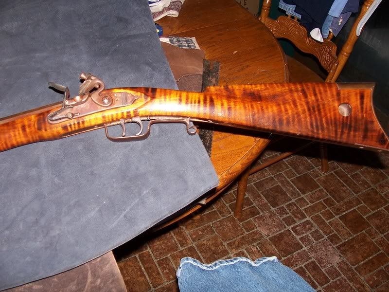

sorry  ;D i did send a pm,explaining how just forgot  to mention it, this is a southern mt rifle i did for a friend the wood is cherry

That is the look I'm after
follow the instructoins and it will do what you wantneed any help callme 1-573-667-5272
like that look, Tom.....cept that locks on the wrong side.......

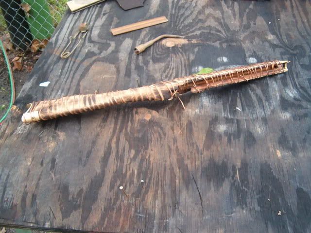

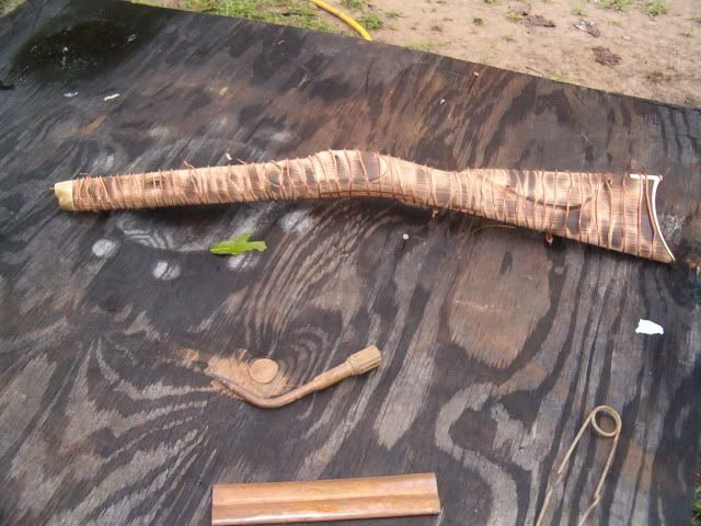

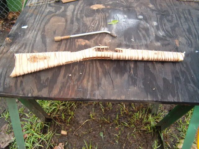

I think I needed to wind the wire closer together
but here is what I have now

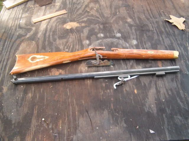

Started with this

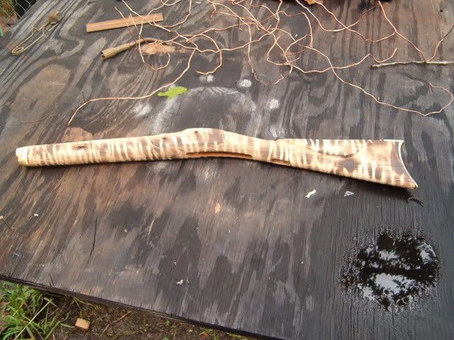

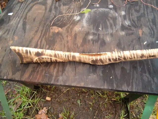

after the torch work

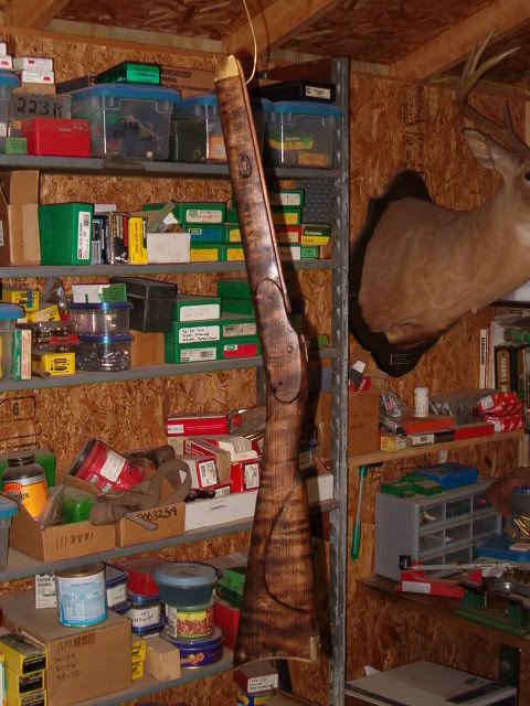

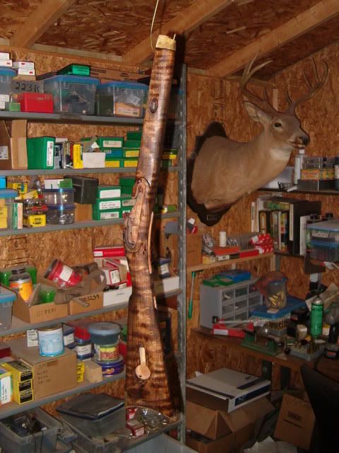

And after resanding, steel wool and staining
